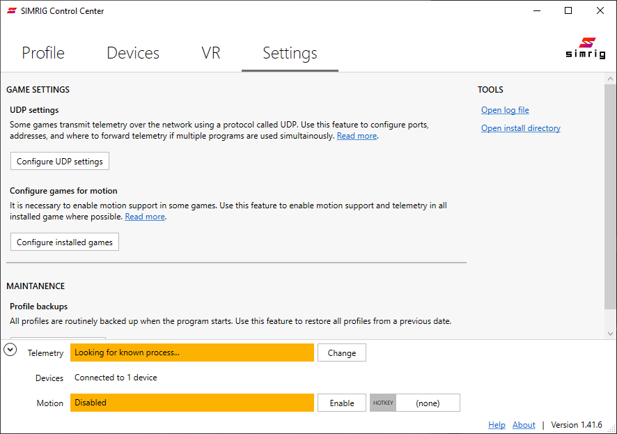

The settings page contains settings and options that affect the behavior of SIMRIG Control Center. It also contains a set of useful tools.
Figure: The Settings page in SIMRIG Control Center.¶
Toolbar¶
On the right-side you will find the toolbar. From here your can open the program’s installation folder and its log file.

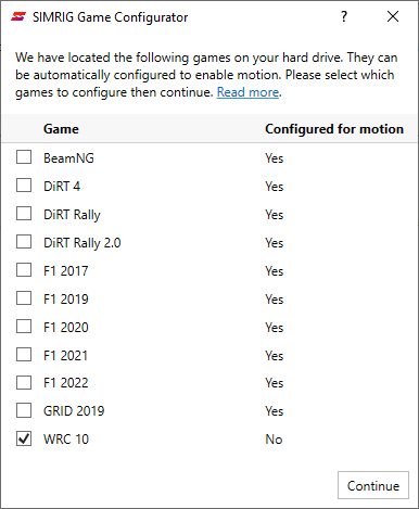

Configure games for motion¶
It is necessary to configure some games for motion. SIMRIG Control Center can automatically find and configure many games. From the settings page you can launch the Configure installed games dialog to automatically find and configure games installed on your computer.
Figure: A list of all installed games that support automatic configuration for motion is shown in this list.¶

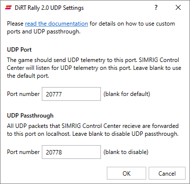

UDP settings¶
From the settings page you can launch the UDP settings configuration dialog. Use this dialog to set custom UDP ports and to enable UDP passthrough. This is also where console users enter the IP address of their console and where they can read their local IP address.
When launched this dialog shows a list of all games with support for custom UDP ports and passthrough:
Click a game from the list to bring up its configuration dialog:
Figure: These are the UDP settings for Dirt Rally 2.0. Other games might present other options.¶

UDP port¶
SIMRIG Control Center uses the game’s default UDP port unless otherwise instructed. When the port number is blank the game’s default port is used. Using the default port is recommended for most users.
If your are using a third-party program alongside SIMRIG Control Center it might be necessary to use a custom port number. Enter this port number into the textbox. The game should send telemetry to this port.
UDP passthrough¶
Warning
This is an advanced topic only of interest to users with dashboards, custom LEDs, fans, and other peripherals. See use cases for details.
Some games only supports a single telemetry receiver – that is, the game cannot send data to two different ports simultaneously. For this reason SIMRIG Control Center features UDP passthrough. SIMRIG Control Center forwards all UDP telemetry to another program on the same device when UDP passthrough is enabled.
Enter a port number in the textbox to enable UDP passthrough. Choose a port number larger than 1024 and less than 65000. Remember to enter the same port number in the third-party program.
