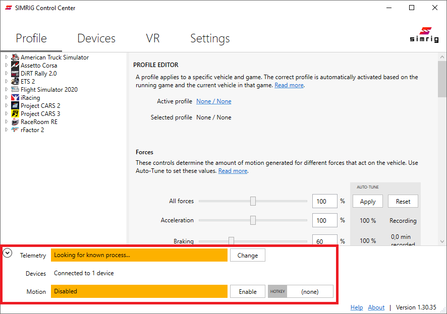

This section will explain the basics of how the system status is presented. The system status is displayed at the bottom the screen.
This is the system status when fully expanded. Use the arrow to contract and expand the system status.¶

SIMRIG Control Center relies on telemetry data to move the rig. This telemetry data is provided by the game you play. SIMRIG Control Center automatically detects which game you play by looking for known processes. It automatically establishes telemetry links with supported games. The Telemetry box indicates if this telemetry link is operational.
Some status messages you may encounter:
- Looking for known process:
SIMRIG Control Center is waiting for a supported game to start.
- PC2 / Searching:
Project CARS 2 is running but no telemetry link has been established yet. Some simulators only send telemetry data during a race or practice session.
- PC2 / Connected:
A telemetry link is established with Project CARS 2. The motion system should receive motion commands.
- PC2 / Timeout:
No telemetry data was detected on the link. The telemetry link will recover when data becomes available. Some simulators only send telemetry data during a race or practice session.

The Motion box indicates if the motion system is enabled or not. Press the Enable button (or Disable) to toggle the motion system on or off.
Note
You must always press the Enable button at every startup to enable the motion system.
Caution
The system may calibrate immediately when enabled or at a later point in time.
